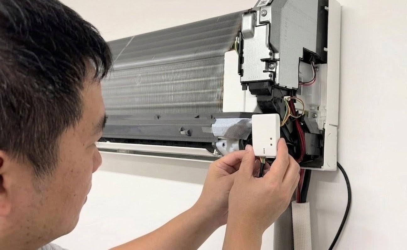

Follow the steps below to set up your wireless interface:
  1. Power down all systems (At the unit and circuit breaker)
  2. Remove the cover to gain access to the control board
  3. Connect a Mitsubishi Electric wireless interface to the CN105 connector on the indoor unit board
  4. Return the cover and power up all systems
  5. At this stage, you should now be able to see a steady green light and four quick blue flashes indicating Bluetooth LE configuration mode. The interface is ready to connect using the app. Three slow, blue flashes repeat after the Connection is complete.
