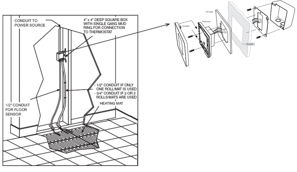

1. Radiant floor heating
This can include radiant air floors, electric radiant floors, and hot water or hydronic radiant floors. Temperature control for these heaters can be achieved through thermostats.
See below sample examples of floor heating control thermostats:
Consider this floor sensor accessory.
