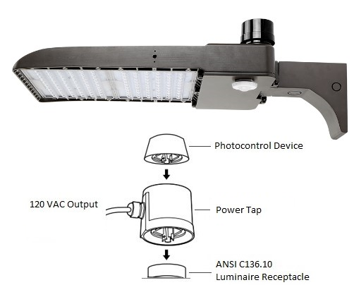

Power Tap on top of a Luminaire
To install the AP-85-PT-1 power tap adapter for Aruba AP-85FX and AP-85LX access points, follow these step-by-step instructions:
  1. Begin by disconnecting any existing power and AC cable connections from the streetlight.
  2. Next, carefully remove the existing photosensor from the power socket on the streetlight.
  3. Plug the AP-85-PT-1 power tap adapter into the power socket on the streetlight, ensuring a secure connection
  4. Take the existing photosensor and plug it into the socket on the top of the power tap adapter, ensuring it is firmly seated.
  5. Locate the AC interface on the Aruba AP-85FX or AP-85LX access point. Screw the opposite end of the power tap adapter into the AC interface, ensuring a tight connection.
  6. Once all connections are secure, turn on the AC mains to supply power to the access point via the newly installed power tap adapter.
