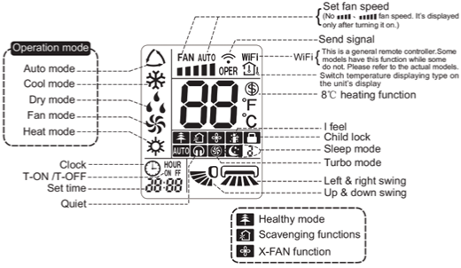

HVAC systems are essential for comfort in homes, offices, schools and other residential areas. Understanding the symbols of your remote can help homeowners in making the most out of their existing units.
In this article, we are going to demystify the symbols on Gree remote controllers. Depending on the remote controller models, the icons that appear on the screen vary.
Gree remote controller buttons
Mode symbols
By pressing the mode button, you can circularly switch between the operation modes visible on the remote's screen: AUTO, COOL, DRY, FAN, HEAT.
Fan Symbol
Appears when the fan is ON.
Wi-Fi Symbol
Displayed when the Wi-Fi function is turned On. This is available on select models.
8° Celsius Symbol
When it is activated, it indicates that automatic heating mode is activated when the temperature is falling below 8°.
Child lock
The padlock symbolshows the status of the unit's lock function.
iFeel
The symbol is displayed when the I FEEL function is on. Temperatures are sent to the main unit every 10 minutes.
Sleep Mode
It appears when the sleep function starts after pressing the Sleep button.
Turbo Mode
Displayed when the quick HEAT or quick COOL mode has been activated.
Left & Right Swing
Activated when left and right swing angle cycling is enabled.
Up & Down Swing
Activated when up and down swing angle cycling is enabled.
Quiet
This mode is available on several models when the Quiet button is pressed
Clock
It displays the current time value after pressing the clock button. It can be adjusted by pressing the t or - button.
T-ON/ T-OFF
Can be ON/OFF when the timer has been set.
Health Symbol
Selectable ON/OFF for healthy and scavanging functions.
