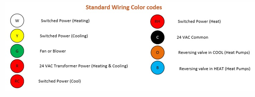

Based on the wires coming out of the wall to the base of your thermostat, various ecobee thermostats can work with your home unit.
For example, if the wires from the wall connects to Rh, G, Y, and C (do not connect jumper wires on ecobee thermostats, they use internal jumper wires e.g. between Rh and Rc) ecobee3 lite should work for you.
Here are examples of the possible base labels on thermostats to which wires can be connected:
Good to note, wire labeled B goes into the O/B connector on your ecobee thermostat and is used to control the heat pump's reversing valve, which switches between heating and cooling modes (see image above on the wire color codes and its functions).
However, on some thermostats, the wire labeled B is the Common (C) wire and it is important to identify if B is used as common wire in your old system so that you connect it appropriately on the ecobee thermostat.
If a common wire is inserted into any connector other than C, the fuse on your HVAC system can be damaged/blown when the system is powered on.  If you are unsure about a wire, we recommend booking a local HVAC specialist to install your ecobee thermostat.
