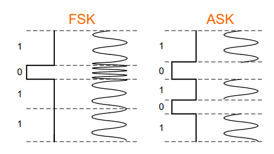

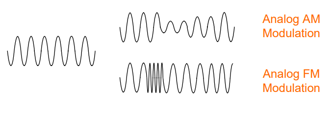

Check below AM, FM, and Chirp analog and digital modulation
In digital transmission, the results of the modulation are 1s and 0s:
• AM (on and off)
• FM (1st frequency 1s, 2nd frequency for 0s)
• LoRa (this is like FSK but switches the 1s and 0 s up and down)

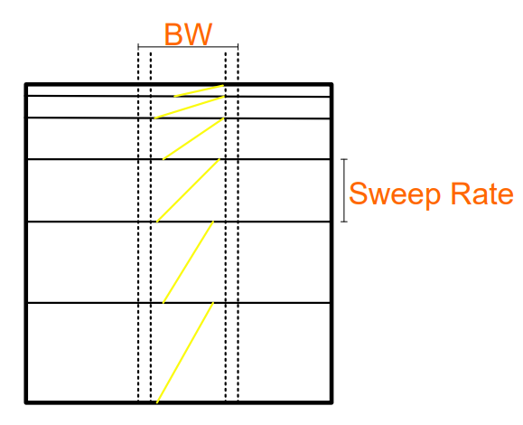

Chirp coding is determined by sweep rate and bandwidth
• BW is restricted (500khz,250Khz, 125khz)
• Sweep rate can be slow or fast. The faster the rate the higher the data but this increases the difficulty in decoding.
