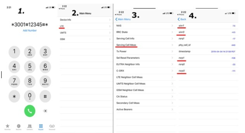

iPhone:
On your iPhone, follow the steps below. Be sure to turn off your Wi-Fi for this exercise.

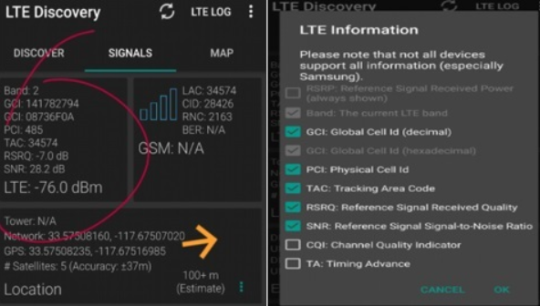

Android:
You can download the LTE Discovery App and check the information below. (You could also use Network Cell Info Lite)
For guidance, you can also use
cellmapper.net to check the direction of a tower and other cell information. With this, select the mobile network operator (MNO) and your location on the left panel and check the towers that are around your location.
